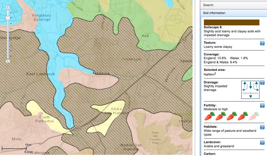

• Many of the soils around the village are, according to more detailed mapping, naturally permeable (see the map below). The run-off rate is normally close to zero unless some compression of the soil has occurred. This means that SuDS have to retain a lot of water.

The map below is from 'Soilscapes', an application run by Cranfield University which provides fine detail of soils on a contrywide map. The detail includes permeability. The cream, pink and hatched brown (Soilscape 8) described in the table on the right) are all relatively highly permeable. The blue areas are also permeable except when the water table is high making them at risk of flooding.
